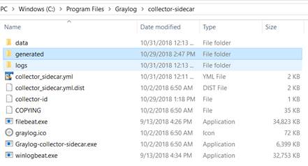

I have downloaded and started the sidecar service on my windows machine. These are the folders that have been created. Attached is the sidecar config yml file.
I have placed the config file for filebeat in ‘generated’ directory. But there are no modules found and getting below error.
“Not loading modules. Module directory not found: C:\Program Files\graylog\collector-sidecar\module”
