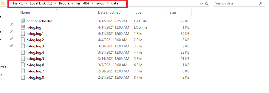

here the log error:
INFO nxlog-ce-2.10.2150 started
ERROR apr_sockaddr_info failed for [PRIVATE IP GRAYLOG SERVER]:12201:514; No such host is known.
WARNING Due to a limitation in the Windows EventLog subsystem, a query cannot contain more than 256 sources.
WARNING The following sources are omitted to avoid exceeding the limit in the generated query: Microsoft-Windows-StorageSpaces-Api/Operational Microsoft-Windows-StorageSpaces-Driver/Diagnostic Microsoft-Windows-StorageSpaces-Driver/Operational Microsoft-Windows-StorageSpaces-ManagementAgent/WHC Microsoft-Windows-StorageSpaces-SpaceManager/Diagnostic Microsoft-Windows-StorageSpaces-SpaceManager/Operational Microsoft-Windows-Store/Operational Microsoft-Windows-SystemDataArchiver/Diagnostic Microsoft-Windows-SystemSettingsThreshold/Operational Microsoft-Windows-TaskScheduler/Maintenance Microsoft-Windows-TaskScheduler/Operational Microsoft-Windows-TCPIP/Operational Microsoft-Windows-TerminalServices-ClientUSBDevices/Admin Microsoft-Windows-TerminalServices-ClientUSBDevices/Operational Microsoft-Windows-TerminalServices-LocalSessionManager/Admin Microsoft-Windows-TerminalServices-LocalSessionManager/Operational Microsoft-Windows-TerminalServices-PnPDevices/Admin Microsoft-Windows-TerminalS
