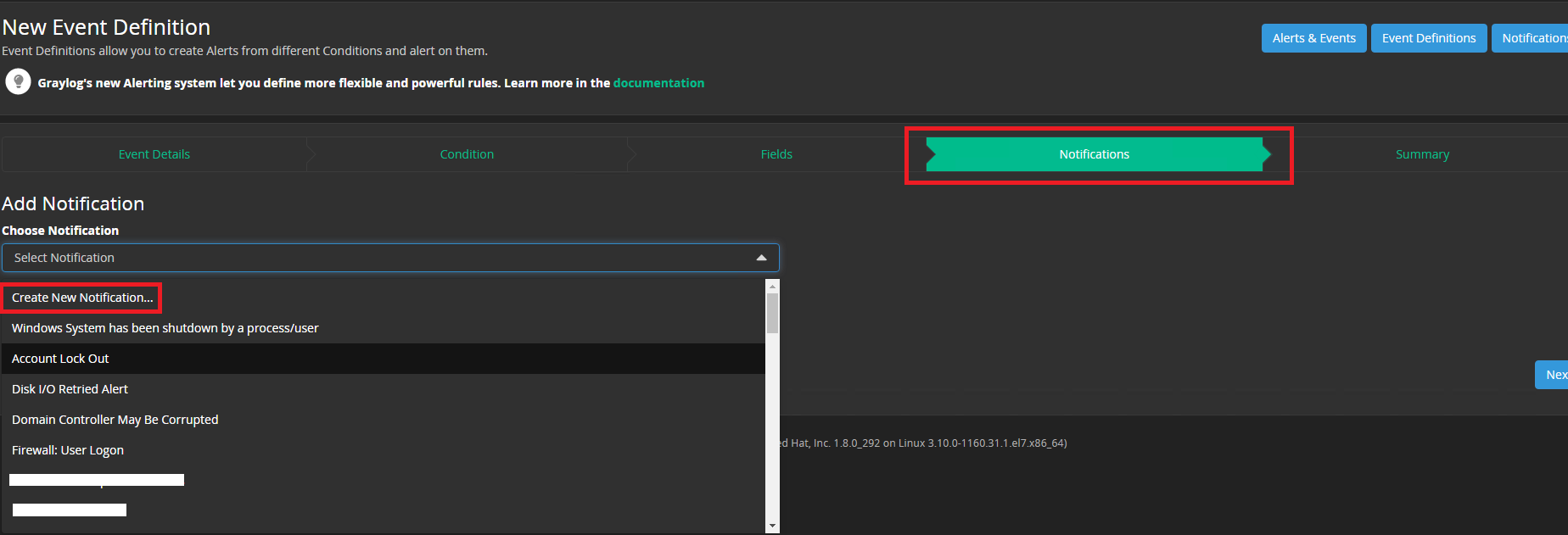

Hello,
Not sure what version of Graylog you are using but this is for Graylog 4.1.
https://docs.graylog.org/en/4.1/pages/alerts.html#alerts
Just navigate to Alerts → Event Definitions → "Create event Definition”.
Once you do that it’s in steps so basically click Next, Next, Next and Finish (Save).
Just fill in the information as you go long. When you get to the "Notification” section click on Add Notification then Create New Notification
Hope that helps
