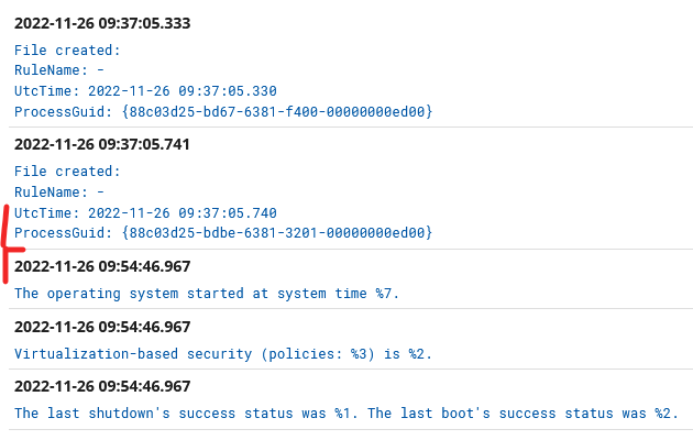

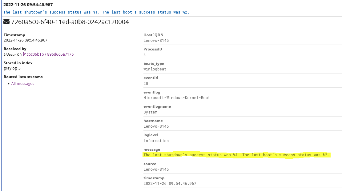

Hi, I’m the creator of the referenced post above, just to confirm that I am still having the issue with Windows 10 22H1, I have not traced the root of the issue very thoroughly but hope someone will have an idea, thank you.

I have machines that run both Windows 10 22H2 and Windows 11 22H2 , and the issue manifests ONLY in windows 11 build.

I am seeing the same issue with Workstations that are running Windows 11 22H2 OS build 22621.819. I currently have two workstations that are having this issue both on the same OS build version. Windows 11 21H2 Build 22000.1219 seem to be fine.

Hi everyone, I wish I had a better answer than this, but unfortunately, this is a known bug that exists within winlogbeat when collecting logs from Windows 11. A member of my team put in an issue with the Beats team for this specific issue, but we have not heard back around prioritization or timing of a fix. The only workaround we have found at this point is a painful one, switching to nxlog for windows event collection. I know this is an untenable solution, and we are working as hard as we can to get the Beats teams to tackle this issue ASAP. Also, if you are utilizing the Graylog Illuminate content for your Windows log processing, the swap of the agent would not require any further work on your part as Illuminate is built to work with both winlogbeat and nxlog.
