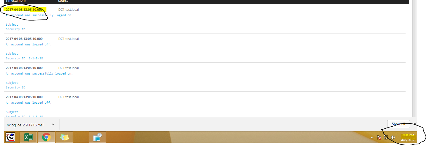

Hi, I have a messages Timestamp coming from client however the timestamp time and my compute time are not the same. Do you know how to fix this problem, please help. Thanks in advance.
see image below
see image below
Hej,
you should check System > Overview what the time settings are.
additional you need to check the Graylog server setting in server.conf - and the timestand of the system you are sending messages from.
happy hunting.
Timestamps in Graylog are stored with the timezone UTC. So unless you’re in Greenwich, England (GMT) or run your computer with the timezone UTC, the timestamp will not be identical to your local time.
