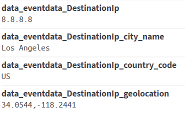

Additionally, here is the output I could obtain without having to do the steps 1 → 3.
I got this by enabling Maxmind Geo IP only
And it already contained Lat and Lon on “data_eventdata_DestinationIp_geolocation” as you can see. so why would I need to do the steps 1 → 3 ?

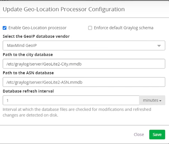

Hi @Bilal-SG ,
I quess you enabled the Geo-Location Processor, right? Then it will do it out of the box.
WIth the pipelines you will be able to fully control the enrichment and not leave it to the magic of the Geo-Location Processor.
Depending on the order of your processing you will be able to split this fields in two fields with pipelines. Is that field a string? you might have a look at the split-function and use the “,” as a delimiter.
