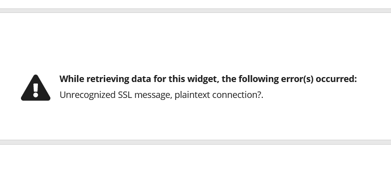

So, https is in and i can access the server, web works BUT, something is f*cked up still.
the inputs cannot start.
Rsyslog also has some issues.

tail to server.log
2022-10-05T12:23:49.668Z ERROR [EventProcessorExecutionJob] Event processor <aggregation-v1/6331812e3b6ca966a645265a> failed to execute: Couldn't create events for: EventDefinitionDto{id=6331812e3b6ca966a645265a, title=windows administrators, description=, priority=2, alert=false, config=AggregationEventProcessorConfig{type=aggregation-v1, query=Administrators, queryParameters=[], streams=[], groupBy=[], series=[], conditions=Optional[AggregationConditions{expression=Optional.empty}], searchWithinMs=3600000, executeEveryMs=60000}, fieldSpec={}, keySpec=[], notificationSettings=EventNotificationSettings{gracePeriodMs=0, backlogSize=0}, notifications=[], storage=[Config{type=persist-to-streams-v1, streams=[000000000000000000000002]}]} (retry in 5000 ms)
org.graylog.events.processor.EventProcessorException: Couldn't create events for: EventDefinitionDto{id=6331812e3b6ca966a645265a, title=windows administrators, description=, priority=2, alert=false, config=AggregationEventProcessorConfig{type=aggregation-v1, query=Administrators, queryParameters=[], streams=[], groupBy=[], series=[], conditions=Optional[AggregationConditions{expression=Optional.empty}], searchWithinMs=3600000, executeEveryMs=60000}, fieldSpec={}, keySpec=[], notificationSettings=EventNotificationSettings{gracePeriodMs=0, backlogSize=0}, notifications=[], storage=[Config{type=persist-to-streams-v1, streams=[000000000000000000000002]}]}

Caused by: java.io.IOException: Unrecognized SSL message, plaintext connection?

Caused by: javax.net.ssl.SSLException: Unrecognized SSL message, plaintext connection?
