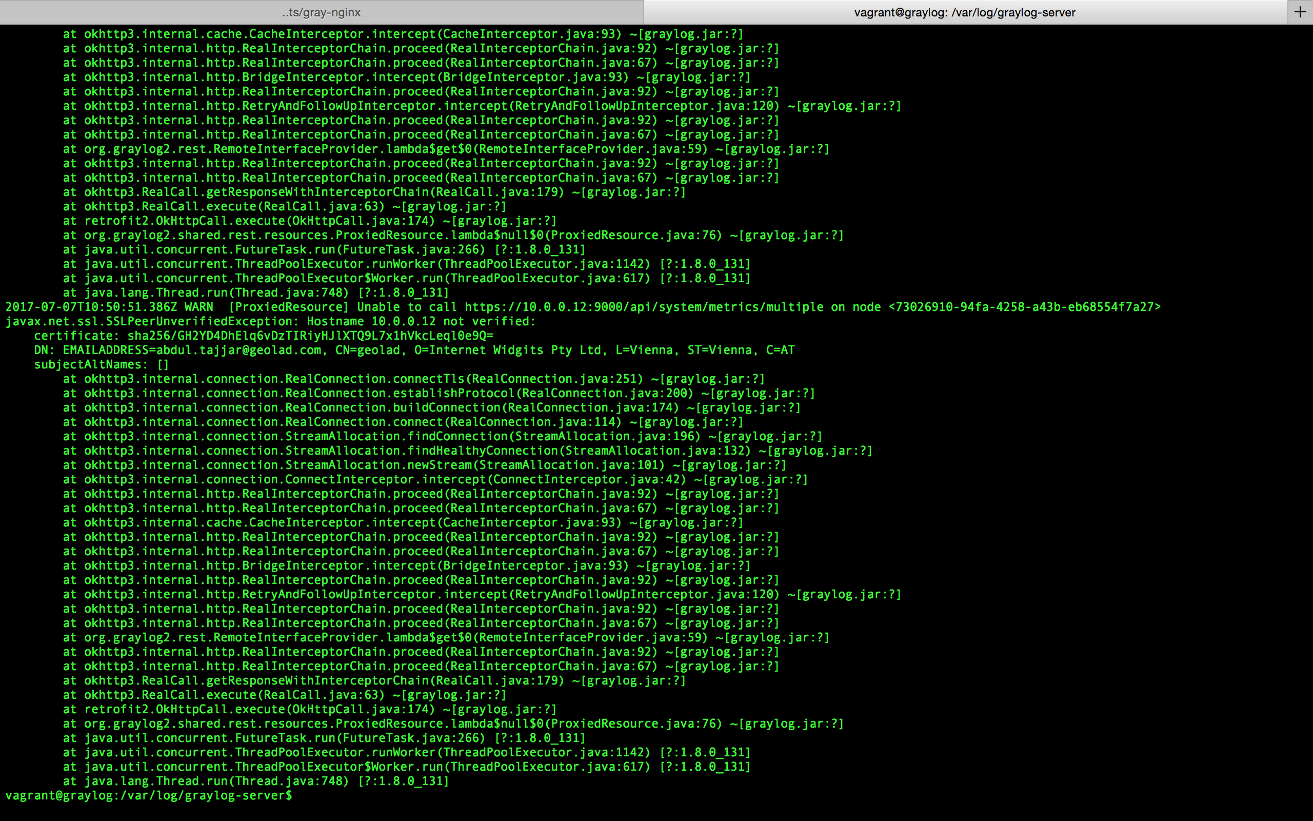

but when I use the certificate my inputs stop running. (i.e.

What is in your Graylog log files?
http://docs.graylog.org/en/2.2/pages/configuration/file_location.html
your hostname does not match the certificate (at least is that the error i can see … )
I noticed that, but I am generating the certificate in that host, so I don’t know so far where the problem lies
“10.0.0.12” (what you’ve configured in the Graylog configuration file in rest_listen_uri or rest_transport_uri) is not the same as “geolad” (which is the Common Name/CN of the certificate you’ve created).

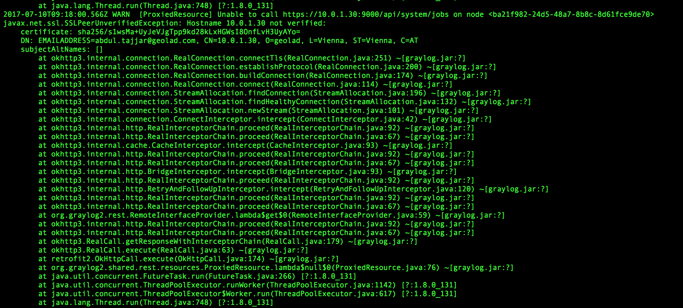

Reproducing the problem:
  • I changed the CN to the ip I am using which is: 10.0.1.30
  • Configured the server.conf as follows:
rest_listen_uri = http://0.0.0.0:9000/api/
rest_tls_cert_file = /etc/ssl/gray-cert/cert.pem
rest_tls_key_file = /etc/ssl/gray-cert/pkcs8-plain.pem
web_listen_uri = https://0.0.0.0:9000/
web_endpoint_uri = https://10.0.1.30:9000/api/
web_tls_cert_file = /etc/ssl/gray-cert/cert.pem
web_tls_key_file = /etc/ssl/gray-cert/pkcs8-plain.pem
  • Added the certificate to the java store,checked that it is there and added the following to JAVA_OPTS:
-Djavax.net.ssl.trustStore=/etc/ssl/cacerts/cacerts.jks"
Output in server.log:
Please tell me what to change in order to get it working.
Cheers
I changed the following:
rest_listen_uri = http://10.0.1.30:9000/api/
rest_transport_uri = http://10.0.1.30:9000/
web_listen_uri = http://10.0.1.30:9000/
elasticsearch_discovery_zen_ping_unicast_hosts = 10.0.1.30:9300
Now I receive a different output:
Thanks a lot Jochen, I had to use a DNS instead of an IP to get it working.
