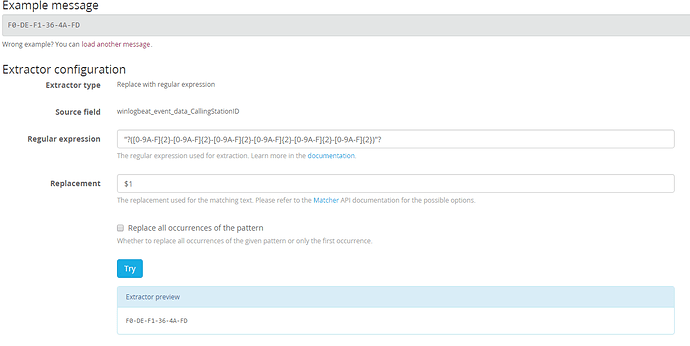

Hi,
please is there any options, how to parse MAC address (00-24-D7-75-AF-6C) without the this character"-"?
i know there is the option to separate by “-”, but if i use this option i must create 6 new fields and I do not want this.
i tried “replace with regular exception”, but without any progress.
could you give me an advice please,how could that be done?
I do not know what to set up in field “replacement”
Thanks for help.
just leave the replacement field empty. And regex wuold be -
And check replace all occurrences of the pattern.
hi,
i can not leave the field “replacement” empty :(.
is there another option to do this?
thanks.
You could try this as the regex
\-(\b)
and
$1
as the replacement
you are the best bro,
Thank you so much!!
