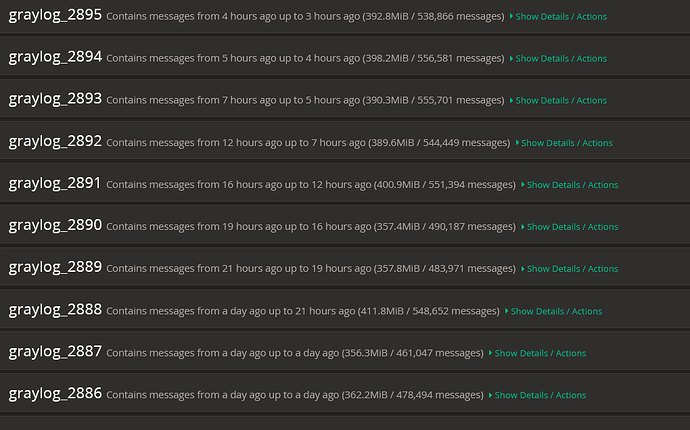

I am seeing this weird behavior where the index set rotates before it reaches the size that is set. For e.g. I had the index set size set to 1 gb before rotating to the next index set but it started getting rotated at around 400mb. I tried changing the size of index set to 530mb but it still rotates short of that. I will attach screenshots below.

We no longer recommend using size based rotation, but i suspect this could possibly be due to index compression. More details about your environment are needed though.

You have Index optimization enabled on this index set. This is a compression process that runs after an index has been rotated, which in my experience typically compresses an index to around 60% of its original size (but note compression rate varies depending on the data within the index).
If your index is rotating at 1GB, it seems within ballpark that the compressed data is ~400MB.
If you disable index optimization, you should find your rotated indices are closer to the 1GB size.
thank you for your responses, I have set the index to rotate based on P1D and that is working very well.
