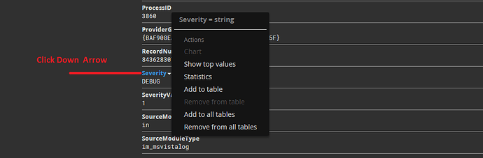

This works good for Windows Systems. The GELF INPUT should create a field called “Severity” as shown from above. You can do this two different ways.
The first way is to look for the field Severity and click the down arrow.
The second way is a global search as shown below.
This all depends on what your doing with this information and how you want to set it up in your environment.
