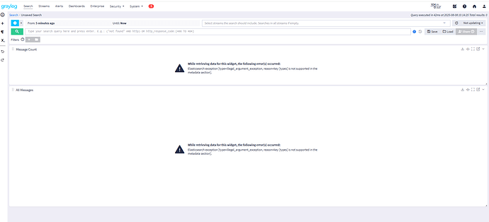

before I upgrade aws opensearch from 2.17 to 2.19, the logs are not displaying on the graylog console and it returns this error.
Executing search failed: SyntaxError: Unexpected token ‘i’, “timeout” is not valid JSON
after upgrading to aws opensearch 2.19, I am now getting the error attached on the screenshot.

more than 2 years already without any problem. even prior to to upgrade, we already have the slow issue. now even the default search with 5 mins time frame is not displaying.
Hello @glennfernandez83,
Another user who experienced the same error contained within your screenshot found that removing the below option from the opensearch.yml file fixed the issue.
compatibility.override_main_response_version: true

Check the option is enabled by running the below.
curl -X GET https://user:password@URL:443/_cluster/settings?include_defaults=true
If it is you can use this next command to disable
curl -X PUT https://user:password@URL:443/_cluster/settings -H 'Content-Type: application/json' -d '
  "persistent" : {
    "compatibility.override_main_response_version" : false
it was 2.17 before we upgraded to 2.19.
this worked and we can now see our logs. however there’s some notifications

I checked this today and can see that opensearch 2.19 is already supported. since we are running aws opensearch 2.19, I decided to set this to true
curl -X PUT https://user:password@URL:443/_cluster/settings -H ‘Content-Type: application/json’ -d ’
“persistent” : {
“compatibility.override_main_response_version” : false
however, I got this error instead.
The Indexer version which is currently running (Elasticsearch:7.10.2) has a different major version than the one the leader node was started with (OpenSearch:2.19.0). This will most probably result in errors during indexing or searching. A full restart is required after a major Indexer version upgrade.
I restarted my graylog master and node but still error persist and logs were not showing again.
