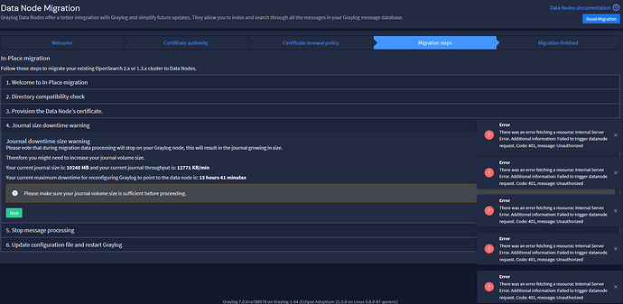

Hello,
I have Graylog 7.0.0-10, OS Ubuntu 24.04, Graylog-datanode 7.0.0-10, Opensearch 2.19.3 - the same as in the Graylog-datanode dist folder.
I do the migration according to the instructions:
When I run migration it shows the error during processing messages:
Error There was an error fetching a resource: Internal Server Error. Additional information: Failed to trigger datanode request. Code: 401, message: Unauthorized

Hi @Rexxer ,
The error message io.netty.handler.ssl.NotSslRecordException: not an SSL/TLS record suggests that your setup has some troubles deciding if it should communicate with (internal) opensearch via http or https.
Have you provisioned certificates during the migration? And if yes, with self-signed or your own uploaded CA? Any chance that you have disabled security somewhere in config?
Which step of the migration is it? Can you post a screenshot?
Thanks!
I used self-signed CA. It’s the step after a journal_max_size warning.

Thank you! This helps, the error is now different and I’ve seen it before. Now I know what’s happening. There is a bug which has been fixed and will be part of the 7.0.1 release scheduled for this week. Meanwhile, you can use a workaround.
In your graylog.conf, please set
indexer_use_jwt_authentication=true
this will force your graylog server to always add the jwt auth header to every datanode request, fixing the unauthorized error you are getting now.
After you adapted the configuration, please restart your graylog server and try again.
It has finished successfully this time.
Thank You very much.
