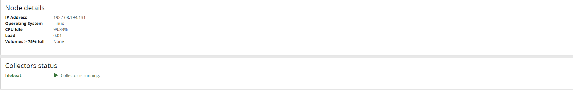

I have configurated this of course, without ssl configuration all works, maybe I don´t express correctly.
http_bind_address = http://192.168.194.130:9000/
http_publish_uri = https://192.168.194.130:9000/
I have this error in the file /var/log/graylog-sidecar/sidecar.log
The front end put that all works perfect… No fails.
