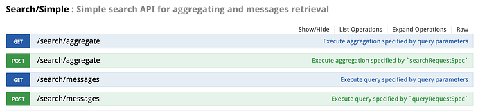

Howdy!
There were some changes to how the API works. I recommend exploring the Search/Simple API endpoints:
