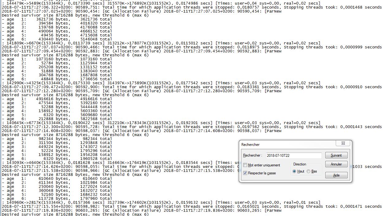

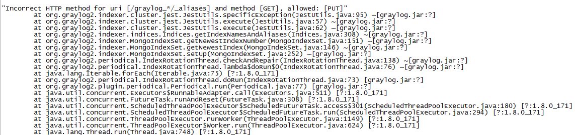

i found a files log of Graylog and Elasticsearch nodes.I have this messages ( look attached documents )
