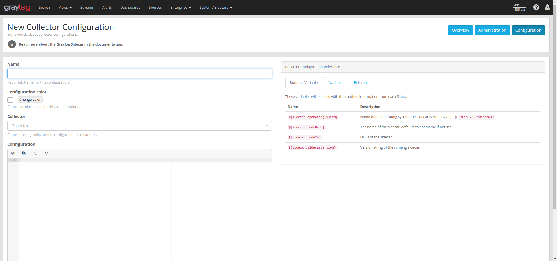

Anyone can help me how to write a sidecar config template for Auditbeat ( Windows )
Binaries are installed on c:\Program Files\Auditbeat
Sidecar is installed c:\Program files\graylog\sidecar
I can’t get it to work config fails
Also if you can provide a link with a better explanation of how to write this template.
I have Winlogbeat running perfectly with the config file provided by sidecar.
I will appreciate it

Maybe a miss understands, what I need is help understanding how to do a “New Collector Configuration”, is this new config, based on the auditbeat yml config file?
why this?
# Needed for Graylog
fields_under_root: true
fields.collector_node_id: ${sidecar.nodeName}
fields.gl2_source_collector: ${sidecar.nodeId}
I can’t find a page in the manual to explain it.

Thanks bro: and yes I did read it and the manual still confusing
I included only 2 modules,
  • module: file_integrity
  • module: system
The file generated by "New Collector Config " GUI is saved by the sidecar on
c:\Program Files\Graylog\sidecar\generated\beatName.conf
not a yml , so how I can check syntax?
The other yml I have is the original that came with Auditbeat install but I thought New sidecar only needs the binaries, sidecar use the config file we generate in the GUI. right?
I had wanted to see if I could get this going - a good morning challenge. Here is the working config I modified off the one you posted. Simple troubleshooting: under sidecar overview, click on the client, then hover your mouse over the failed beat and it will give a comment about what it doesn’t like.
output.logstash:
   hosts: [${user.BeatsInput}]
path:                                                               #missing
  data: C:\Program Files\Graylog\sidecar\cache\winlogbeat\data      #missing
  logs: C:\Program Files\Graylog\sidecar\logs                       #missing
tags:
    - windows                                                       #added
    - auditbeat                                                     #added
auditbeat.modules:
- module: file_integrity
  paths:
  - C:/windows
  - C:/windows/system32
  - C:/Program Files
  - C:/Program Files (x86)
- module: system
  datasets:
    - host      # General host information, e.g. uptime, IPs
    - process   # Started and stopped processes
#   - login                                                         #!!linux only
state.period: 12
user.detect_password_changes: true                                  #added
#processors:                                                        #Commented out
#  - add_host_metadata: ~                                           #Commented out
#  - add_cloud_metadata: ~                                          #Commented out
